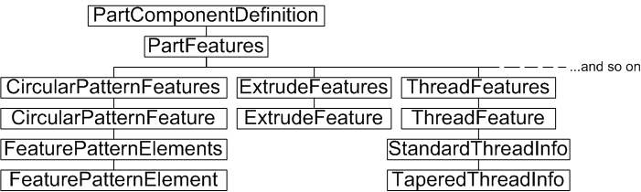

Features Object Model Diagram
The following is a list of current API feature objects. Not all are available at the same time - it depends on the document or environment type. For example, the FlangeFeature object only has meaning in the context of a sheet metal part.

Working with Features through the API
A part component definition provides access to the collection of features to be applied to that part. This PartFeatures object is a collection of other part feature collection types. For example, the ExtrudeFeatures object is a collection of ExtrudeFeature objects. Creating an extrude feature is as simple as adding it to this collection. However, most features require some further input, perhaps in the form of mirror or rotation axes, sketches or profile objects, or radius dimensions, to help define the appropriate result.

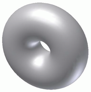

The intention here is to rotate, or revolve, the circle around the axis formed by the sketch line, thus forming a doughnut shape. The next step is to form a profile from the circle sketch. Note that the AddForSolid method is used again. The only contiguous closed loop in the sketch is the circle, which is the only object that will be used in the resultant profile.
Dim oProfile As Profile
Set oProfile = oSketch.Profiles.AddForSolid
The only remaining step is to add the RevolveFeature to the RevolveFeatures collection. Here the AddFull method is used, indicating that the revolve should rotate through a full 360 degrees. The alternative is the AddByAngle method. The sketch line is used as the rotation axis.
Dim oRevFeature As RevolveFeature
Set oRevFeature = oPartDoc.ComponentDefinition.Features.RevolveFeatures.AddFull _
    (oProfile, oLine, kJoinOperation)
oApp.ActiveView.Fit
This RevolveFeature sample code results in a 3D solid appearing as follows:
