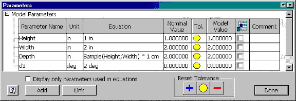

This function has two input arguments. If we look at the use of this function in the Parameters dialog, you can see that two parameters are passed in as input values for these arguments. These two parameters happen to define length units and in this case have the values 1 in and 2 in. When Inventor calls the VBA function these values will be converted to length database units (centimeters). So the values the function receives will be 2.54 and 5.08. If one of the input arguments happened to be the parameter d3, the value received by the function would be 0.03490658, which is 2 deg converted to radians. Radians are the internal database unit for angles.

The VBA function is used the same way as the built-in functions are used in Autodesk Inventor. One requirement that is easily overlooked is that the separator between arguments is a semi-colon, not a comma.
The figure below illustrates using the user-defined function in the Parameters dialog.
