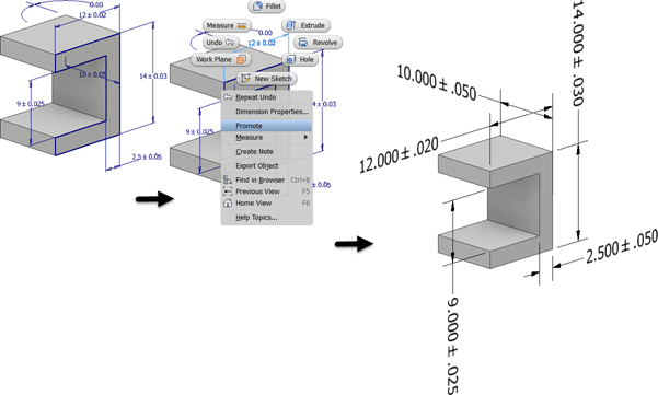

Use the General Annotation commands to add dimensions, hole notes, and surface texture symbols to the 3D model.
Before you begin, set the units in Document Settings, Standards tab, and then select the desired standard in the Annotations, Active Standard drop-list.
General Annotation panel
Dimension
Change the required dimension values and then click OK.
If the model dimension includes tolerance information, it is included in the promoted dimension.

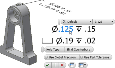

Hole/Thread Note
Change the required values and then click OK.
