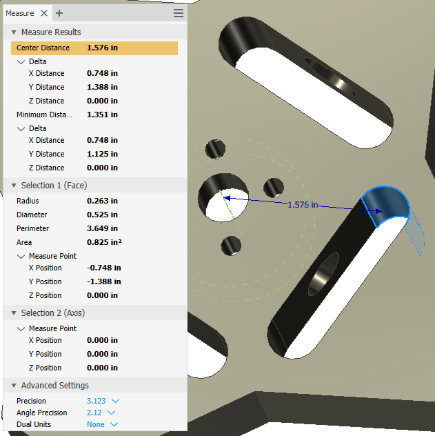

| Measure Linear Distance, Length, Angle, Loop, or Area
Information on each selection displays in the measure tool panel and in the graphics window. The Measure tool panel shows all possible values for your selections as well as the result from both selections. Clicking a value in the Measure tool panel displays the selection and the measurement in the graphics window.

- In the graphics window, click to select geometry to measure:
- Length of an edge Click to select the edge.
- Diameter of a cylindrical face or circle Select the face or edge.
- Radius of a cylindrical face or arc Select a face or arc.
- Position of a point from the origin Click to select the point. The position of the point relative to each axis of the active coordinate system displays.
- Distance between points
Click to select the first point, and then click to select the second point. When you select the second point, the position of the point from the origin and delta position relative to the first point displays.
- Distance between any 2 of the following geometries: Lines/axis, arcs/circles, splines and any type of surfaces Click to select the first geometry, and then click to select the second geometry.
Distance between two components in an assembly (not available in Inventor LT) Select the first component, and then select the second component. A minimum distance value displays. The minimum distance between two components can be an edge, face, or vertex.
