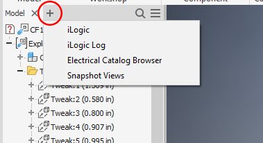

Both independent and linked snapshot views are listed in the Snapshot Views panel. If the Snapshot View panel is not visible you can access it by clicking the '+' sign in the Model browser title bar.
