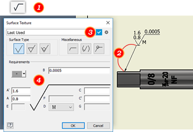

Symbols panel
Surface .
Hover over an edit box to display a tooltip with detailed description.
Force tail adds a tail to the symbol.
Majority indicates that this symbol specifies the standard surface characteristics for the drawing.
All-round adds the all-round indicator to the symbol. The diameter is specified in the Leader style.
Defines the values for the surface characteristics. Enter the appropriate values in the boxes. The layout of the fields is determined by the surface texture style.
to add graphical symbols to the requirement fields. Click in the field and select the symbol to add there.
and accept the default name or specify one based on your naming conventions.
