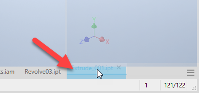

Add a document to the window by dragging a document tab into the tab bar until the blue frame edge previews below the tabs, then drop it. The document window remains a single document type.

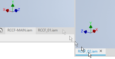

Create a new application window by dragging a document tab and dropping it in the graphics display, desktop, or another monitor.
Create a new application window set
by dragging the set tab bar out of the main window to the graphics display, desktop, or another monitor

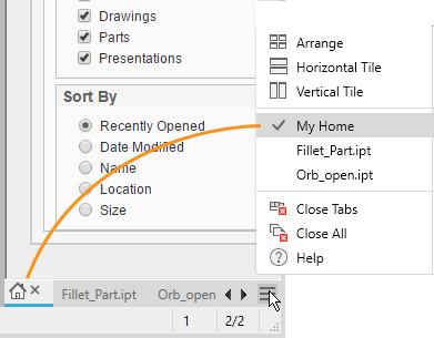

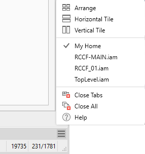

You can create window layouts using the Documents menu at the right end of the window tab bar.
Arrange - arranges all documents in the current window in a grid. Tab groups are dispersed into individual documents. All minimized documents are ignored.
