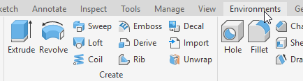

Access Environments Within Part File
  1. In a Part file, on the ribbon, click the Environments tab.
  2. Click one of the available environments.
    • Inventor Studio
    • BIM Content
    • Stress Analysis
    • Dynamic Simulation
    • Cable and Harness
    • Tube and Pipe
    • 3D Print
Note:
  • Dynamic Simulation, and Stress Analysis are available in both the Autodesk Simulation products and Autodesk Inventor.
  • Cable and Harness, and Tube and Pipe are available only in Autodesk Inventor.
  • Inventor Studio and BIM Content are available in all products, including Inventor LT.

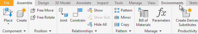

Access Environments within Assembly File
  1. In an assembly file, on the ribbon, click the Environments tab.
Note: Dynamic Simulation and Stress Analysis are available in both the Autodesk Simulation products and in Autodesk Inventor Professional. Cable and Harness, and Tube and Pipe are available only in Autodesk Inventor Professional.

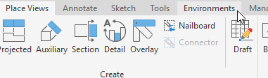

Access Environments within Drawing File
