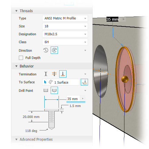

- Optional - check the panel menu to see if the options you want are active. The two options are:
Preselect sketch center points - causes all unused sketch center points, in the active sketch, to automatically be selected for use by the Hole command, populating each center point with a hole. Use Ctrl+click to remove center points from the selection set. Clear the option to disable pre-selection.
- Keep sketch visible on ( + ) - when using the Hole command, if unused sketch center points exist when you click
(Create new hole), the sketch is automatically shared and visible for use with creating the next Hole. If you do not use the sketch for the next hole or click Cancel or Esc, the sketch will be unshared. You can share a sketch manually by right-clicking the sketch browser node and clicking Share Sketch. This option is available only in the Part environment.
- Window select center points only - by default the setting is
ON and window select captures only center point objects. If you want to select any type of point object, which is the legacy behavior, click to turn the setting
OFF.

Hole Type
Simple hole creates a plain hole without a thread. No additional settings are needed.
Clearance hole creates standard, untapped (and usually through) holes that are matched to specific fasteners. Use them to create clearance holes for standard fasteners based on a library of standard fastener data.
Note: Fastener information can be included in hole notes in drawings.
To manage clearance data, Autodesk Inventor uses the Clearance.xls Microsoft Excel spreadsheet file, which is located in the Design Data folder. The Application Options or project settings affect the location of the spreadsheet file. You can change the order in the file so that the clearance you use most frequently is presented first. Edit the clearance spreadsheet and change the sort order number (from 1 to n) in cell B1 of each sheet to match your priority. To activate the new sort order, restart the program
Tapped hole creates a hole with a thread that you define. Specify tapped holes in either English or Metric standard sizes. For part hole features you can select a common thread size from a list and its diameter is calculated.
Taper Tapped hole creates a hole with a taper thread that you define. Specify the thread type and size and right-hand or left-hand direction, and Autodesk Inventor automatically determines the diameter, taper angle, and thread depth. Specify taper tapped holes in either English or Metric standard sizes.
- Specify the hole Termination options:
Threads enables when the Tapped or Taper Tapped hole type is selected. Specify the hole parameters:
- Type specifies the thread type. Select from the list of standard threads.
ANSI Unified Screw Thread is an example of an inch-based thread type. ANSI Metric M Profile is an example of a millimeter-based thread type. NPT is an example of an inch-based thread type. ISO Taper Internal is an example of a millimeter-based thread type.
- Size specifies the thread size. Select from a list of nominal sizes for the selected thread Type.
Each nominal size has one or more pitches available. Each nominal size and pitch combination has one or more classes available.
Designation specifies the thread pitch.
Pitch is the distance from a point on a screw thread to a corresponding point on the next thread measured parallel to the axis.
Note: If you use imperial units, the pitch is equal to 1 divided by the number of threads per inch.
Diameter displays the diameter value for the hole feature type. This value relates to how drawing views represent the threads.
To change this value go to Tools
Options
Document Settings
Model tab. Change the Tapped Hole Diameter value. The hole diameter is set automatically based on the thread specification in the Thread.xls.
- Class specifies the class of fit for the internal thread.
Note: For English threads, the letter A represents external threads, and B represents internal threads. Use higher numbers for more accurate, closer fitting requirements. For instance, use 2B for screws, bolts, nuts, and other general applications. Use 3B for highly accurate and close-fitting requirements.
- Full Depth specifies threads for the full depth of the hole and can only be specified for tapped holes.
- Direction specifies how the threads wind.
Left Hand, the threads engage in a counter clockwise and receding direction when viewed perpendicular to the hole axis. A left-hand threaded bolt advances into the nut when turned counter clockwise.
Right Hand, the threads engage in a clockwise, receding direction when viewed perpendicular to the hole axis. A right-hand threaded bolt advances into the nut when turned clockwise.
