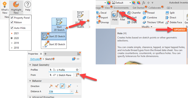

    To Show Highlight Badges on New or Updated Commands and Property Panels
  1. On the Get Started tab > New Features panel click Highlight New . The list of Releases and Updates displays. Off is the default setting.
  2. Select a release or update. Badges display on the Ribbon commands that were updated or new after the selected release or update. For example, in the following image commands that were new or updated after 2018.3 will have badges on them.
To Hide Badges
To hide the badges, uncheck either Property Panel or Ribbon. At any time you can turn them back on and refresh your memory about the new or updated commands.
The Auto-Hide option turns off the badge display after first use of the command or option. This makes it possible to work through the new or updated commands and know which ones you have not used or explored. Turn off Auto-Hide to keep the badges visible.
Property Panel Badges
Badges on property panels indicate new feature options and feature options that are not readily visible, such as those on the Advanced Settings menu. You can change the badges display by selecting or deselecting the box in the Highlight New dropdown menu.

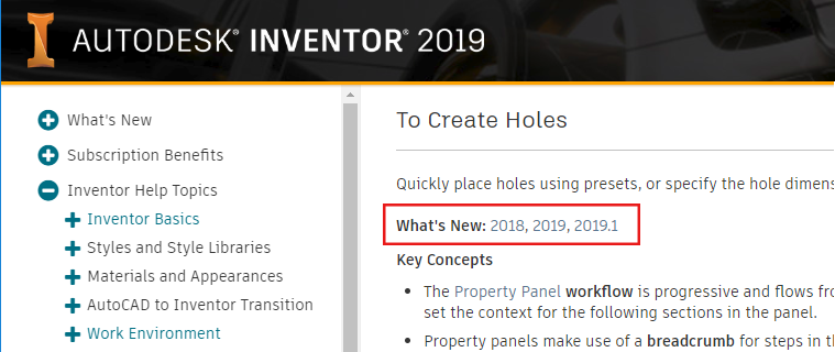

Corresponding Help Page Change
For commands displaying a New or Updated badge, when you use F1 to get to a Help page, at the top of the page you will see links to the What's New topic that explains the change to the feature or command. The links show the release in which a related change took affect.
