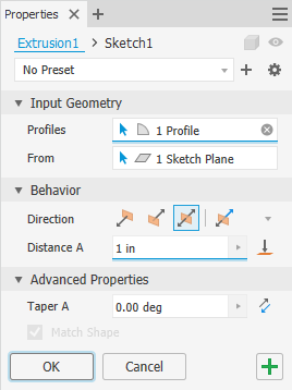

  1. On the ribbon, click 3D Model tab Create panel Extrude .
    If there is only one profile in the sketch, it is selected automatically. Otherwise, select a sketch profile.
  2. At the top of the property panel is the breadcrumb. To the right of the breadcrumb is the feature type. The type determines the options presented in the property panel.
      Specify the feature type you want to create:

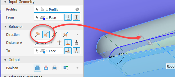

  4. Specify the Behavior parameters, first choosing from the available options:
    • Direction: Default - Extrudes in one direction only. The extrusion end face is parallel to the sketch plane.
    • Flipped Direction - Extrudes in the direction opposite of Direction.
    • Symmetric - Extrudes in opposite directions from the sketch plane, using half the specified Distance A value in each direction.
    • Asymmetric - Extrudes in opposite directions from the sketch plane using two values, Distance A and Distance B. Enter a value for each distance. Click to invert the extrude direction using the specified values.
    • Distance A - specifies the depth of extrusion between start and end planes. For a base feature, shows negative or positive distance of extruded profile or entered value. Dragging the manipulator will modify the value.
    • Distance B - specifies the depth in the secondary direction. Displays when Asymmetric is selected.

  6. In the Advanced Properties section you can specify additional options.
    • Taper A - sets a taper angle from 0 to 180 degrees normal to the sketch plane. The taper extends equally in both directions.
      A positive taper angle increases section area along the extrusion vector:
      A negative taper angle decreases section area along the extrusion vector:

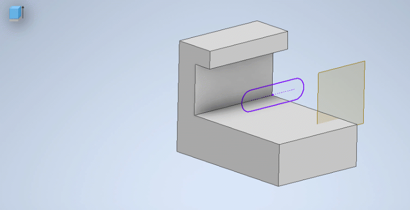

Create an extrusion terminating at a distance from a face
The profile sketch does not have to lie on the originating plane for the extrusion.
  1. Click 3D Model tab Create panel Extrude .
  2. If there is only one profile in the sketch, it is selected automatically. Otherwise, select a sketch profile.
  3. Select the face, work plane, or surface from which to start the extrusion. The option Extend face to end feature automatically activates when the From selection does not intersect the extruded profile. You can manually change the option.
  4. Specify the Behavior options, which could be direction and distance, to another face, and so on. Based on the selection the Terminate feature by extending the face option may be turned on. If the solution is ambiguous, such as when terminating to a curved surface, try applying the Alternate Solution option.
    Note: When working with a multi-body solid, you will need to specify the extrusion as part of another body by activating the Solid(s) selector and clicking the desired body or as a new body.
  5. Click OK or (Create new feature) to continue defining revolved features.
