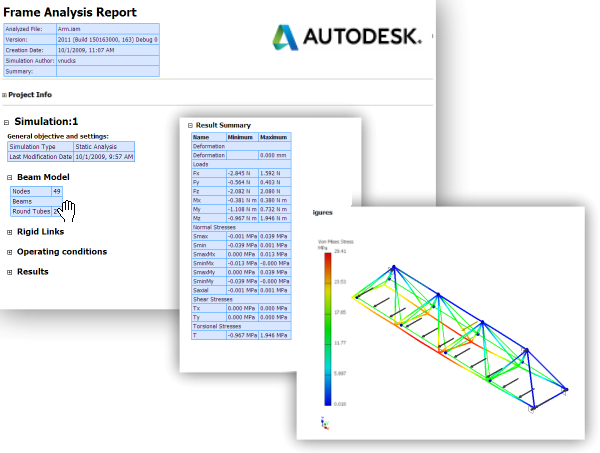

You can create reports for the entire project, a model, or a single simulation study, and output them in HTML, MHTML, or RTF format. Reports contain text and PNG images that represent a static snapshot of the analysis results. You can print a report, and transfer results to another program, such as Word or PowerPoint.
Report output can be customized to display only pertinent information.
