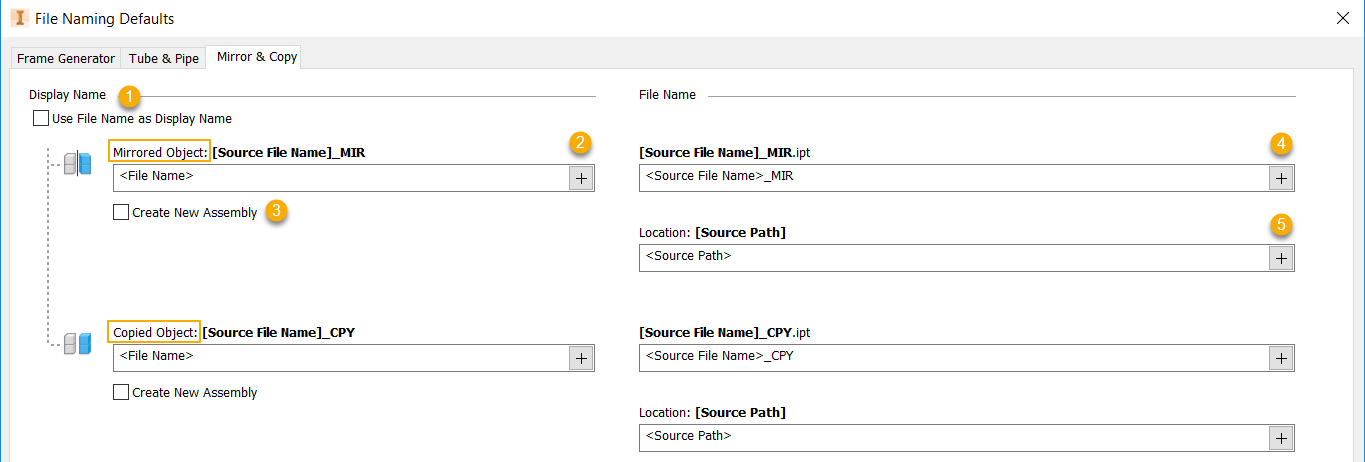

Specify how Mirror and Copy create files and folders.
- To use the file name for the name of the browser node: Select
Use File Name as Display Name. Deselect the checkbox to customize the name of the browser node.
- To configure the naming scheme: Click the plus sign
and make a selection. Click the plus sign again to further customize the name.
- To create a new assembly file that contains the mirrored or copied items: Select the Create New Assembly checkbox.
- To specify the file name: Click the plus sign
and make a selection. Click the plus sign again to further customize the name. Click the plus sign again to create additional folders.
- To specify the folder path: Click the plus sign
and make a selection. Click the plus sign again to further customize the path.
