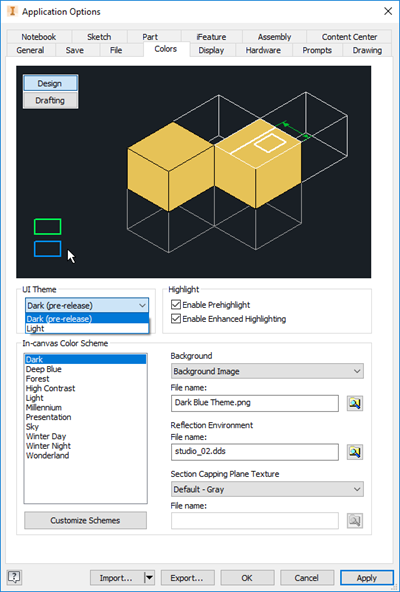

- A new Dark (pre-release) theme is added. When you choose Dark (pre-release), a brief message is presented. Click Continue to see the Dark (pre-release) theme. The Details button brings you to this topic.
- UI Theme list appears first in the controls on the Colors tab because the theme affects the Color Scheme values. You'll want to test your Color Schemes with the new theme.
- Easily switch between Dark and Light themes. The general interface updates to display the chosen theme.
- On the
Tools tab
Options panel, click
Application Options.
- In the UI Theme section, click the drop down and choose
Dark (pre-release). The UI theme is applied.
- When Dark (pre-release) is active, the Amber icon option is disabled. Amber icons are not enabled for the dark theme.
- A new Dark color scheme with complementary color values is added.
- The color scheme Light Theme was renamed to Light to help distinguish it from the UI Theme.
- Dark theme is not available in some add-ins at this time. These are a work in progress.
