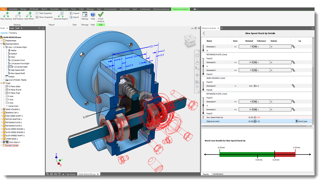

AutodeskĀ® InventorĀ® Tolerance Analysis is a CAD-embedded, 1D tolerance analysis software that helps you more clearly understand the impact of mechanical fit and performance based on the cumulative dimensional variation.
A 1D tolerance stackup means the distance being analyzed and all dimensions that contribute to the distance variation are acting in the same linear direction. Linear variation of the surfaces on either side of the stackup direction is considered; angular variation of the surfaces relative to each other is not considered. Sometimes the effects of angular variation are overlooked, so you should verify the analysis in 1D.

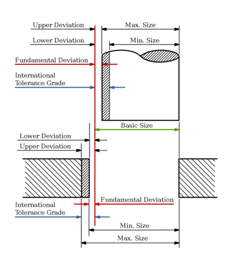

The purpose of tolerance design is to consider the allowable variation in each part to determine if the engineering requirements are met when the parts are assembled.

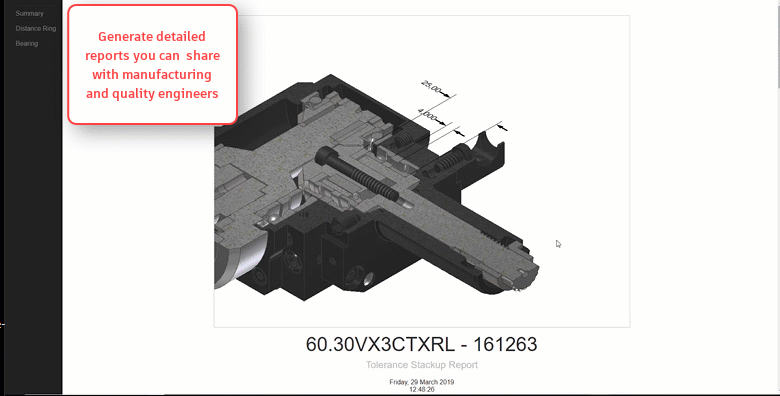

Tolerance Analysis also helps you understand the cost impact of dimensional variation by providing you with information to help you:

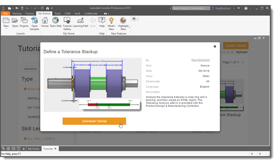

You can start using Inventor Tolerance Analysis by installing Tolerance Analysis from your Autodesk account. Next, learn more about the workflows in Tolerance Analysis by running your first analysis and then working your way through the Guided Tutorial.

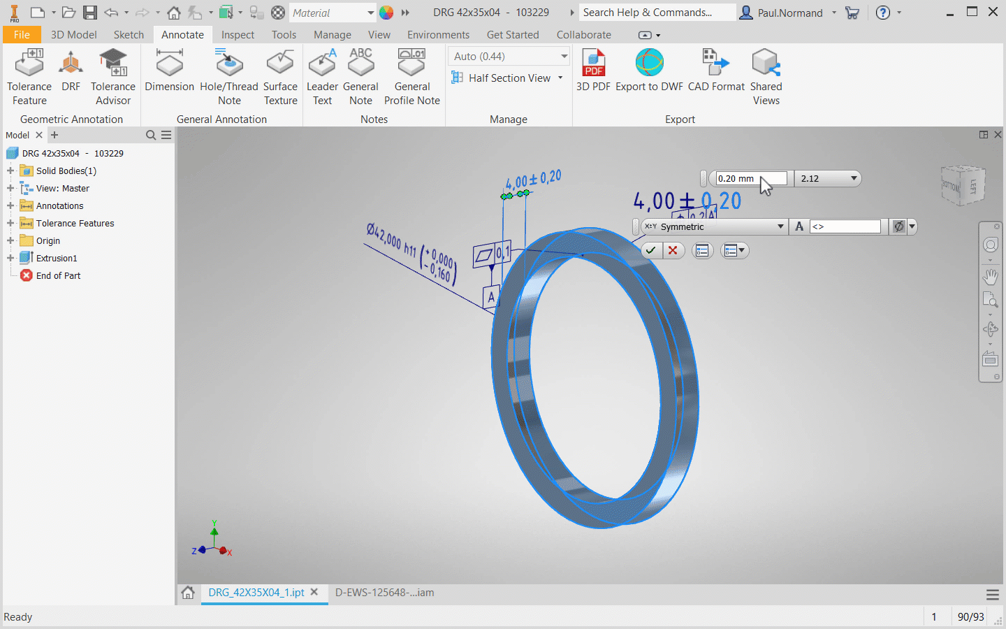

Manufacturing tolerances have a significant impact on cost and quality. After adding 3D tolerance annotations or tolerance features to your Inventor model, use Tolerance Analysis to create the stackup and provide an interactive summary of the stackup results.
