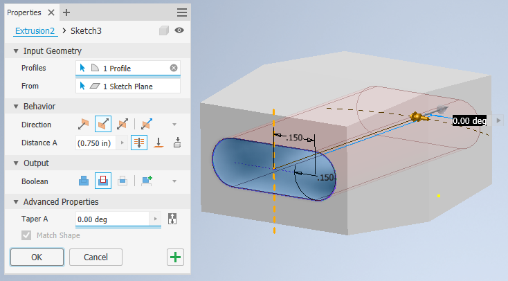

To learn more about working with Extrude see To Create Extruded Features.

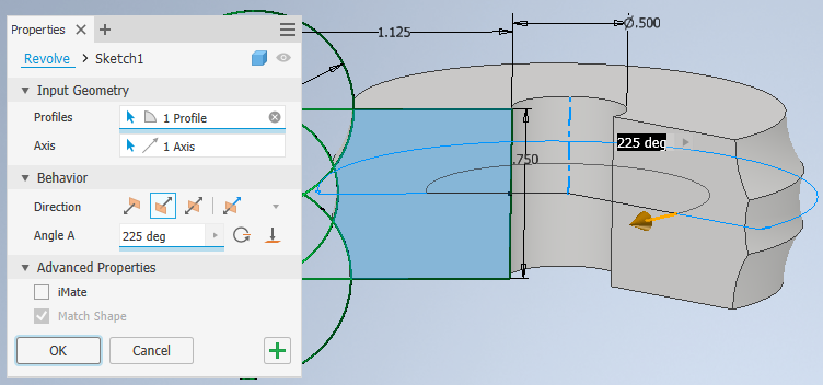

To learn more about working with Revolve see To Create Revolved Features.

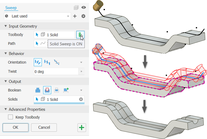

In addition to the property panel, the Sweep command now supports sweeping a solid.
To learn more see To Create Sweeps.
