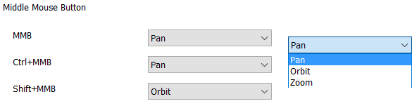

The Display tab in the Applications Options dialog box now provides settings where you can map the middle mouse button to zoom, pan, or orbit.
For more information, see Application Options Display Tab Reference.

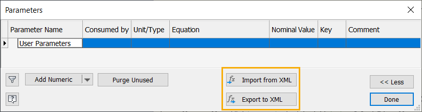

The ribbon commands, Manage tab
Parameters Panel,
Import from XML
and
Export to XML, can now also be accessed from the Parameters dialog box.
For more information, see To Work with Parameters in Models.

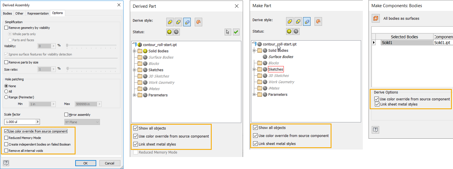

The following Derive settings now persist across sessions when creating a derived part. By default, each of these settings are checked. Deselecting a setting will result in the setting remaining deselected until you select it again.
For more information on creating derived parts, see To Create a Derived Part or Assembly.

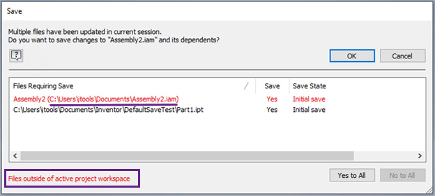

The Save has been enhanced to allow you to quickly identify files you're about to save that aren't in your active project. Files not in the active project display in red.
Additionally, files that have not been saved to disk display the save path as a suffix to alert you to the destination.
For more information, see Save Dependents Dialog Reference.
