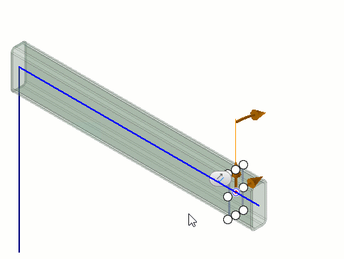

Frame Generator
The orientation values for the manipulator are now editable dimensions in the display.
For more information on frame generator, see To Create Basic Structural Frames.

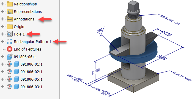

3D PDF Export
3D PDF Export of assemblies now supports assembly features and 3D annotations.
Note: Weld Preparation and Machining features are supported. Weld beads are not supported.
For more information on 3D PDF, see To Export a Model to 3D PDF.
