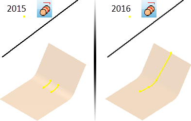

The create silhouette curve command includes new options. You can now choose to exclude selected faces, straight faces, and internal faces from curve generation.
