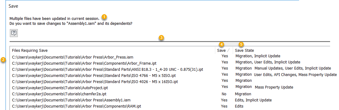

New Save settings give you more control over when Inventor prompts you to save.
When you close a file, a Save dialog box displays the list of files that were impacted in some way as a result of the file being opened. Sometimes, system level changes occur with little or no loss of design intent, and if not saved, can be saved later. Sometimes a prompt to save is not necessary. The new Save settings give you more control over when Inventor prompts you to save.
Use the new controls in the Application Options/Save tab to set the behavior when Inventor prompts you to save.

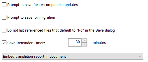

The Save State prompts replace the Prompt to save for re-computable updates, Prompt to save for migration, and the Do not list referenced files that default to "No" options.

The Save dependents dialog box is enhanced to provide additional information pertaining to file status (assemblies not available in Inventor LT).
For more information, see Save Dependents Reference.
