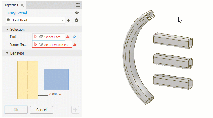

The Trim/Extend command now supports selecting a curved face to define the Tool.
For more information, see To Modify or Apply End Treatments to Frames.

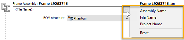

File Naming Defaults dialog box is enhanced with new features and updated to increase productivity.
The following enhancements are added to the Frame Generator tab:
button and is accessed as shown in the following image:
For more information, see To Customize Frame Generator File Names and Folder Structure.
