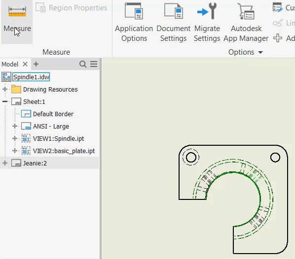

A new command, Centerlines, is added and the Measure command is now supported in drawings.
Use the new ribbon command,
Annotate tab
Symbols ribbon panel
Centerlines
to specify centerline behavior for the selected view. Default centerline behavior is defined from the Drawing tab in the Document Options dialog box. To change the behavior for an individual view, select a view and configure the settings.
For more information on centerlines, see Automated Centerlines Reference.
The Measure command is now available in Drawing Files
For more information on working with the Measure command, see To Measure Distance, Length, Angle, Loop, or Area in Model.
