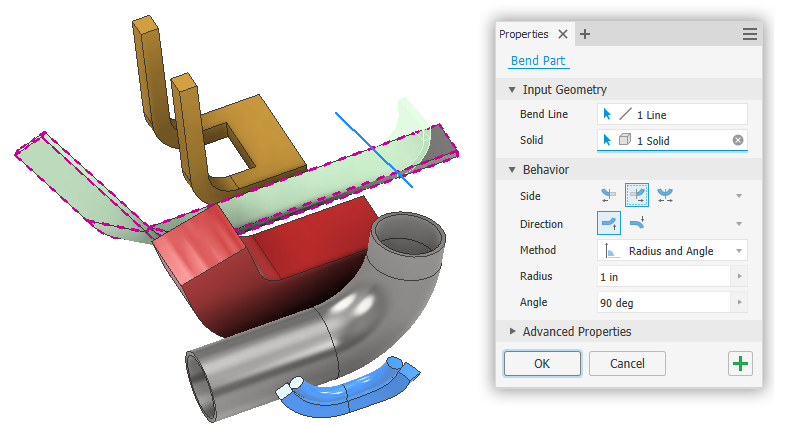

Bend
For more information about the Bend command, see To Bend Parts

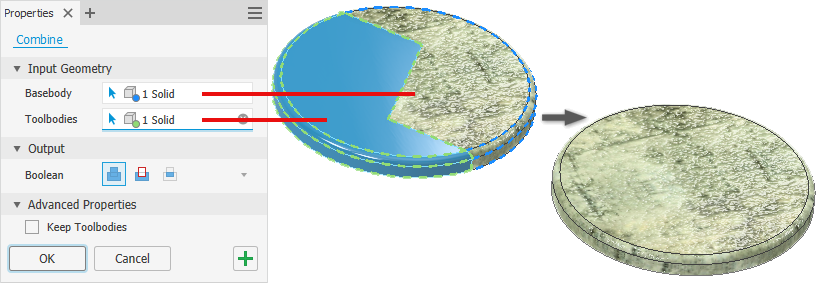

Combine
For more information about the Combine command, see To Combine or Split Bodies or Faces

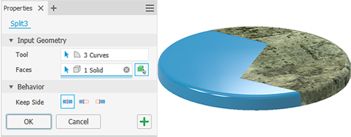

Split
For more information about splitting faces and bodies, see To Combine or Split Bodies or Faces

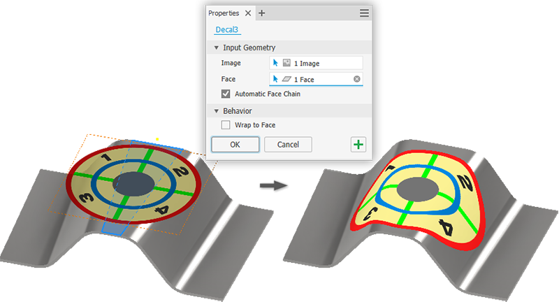

Decal
For more information about Decals, see To Emboss or Add Decals to Parts or Surfaces

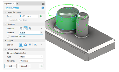

Thicken/Offset
For more about the Thicken/Offset command see: To Thicken Faces or Offset Surfaces

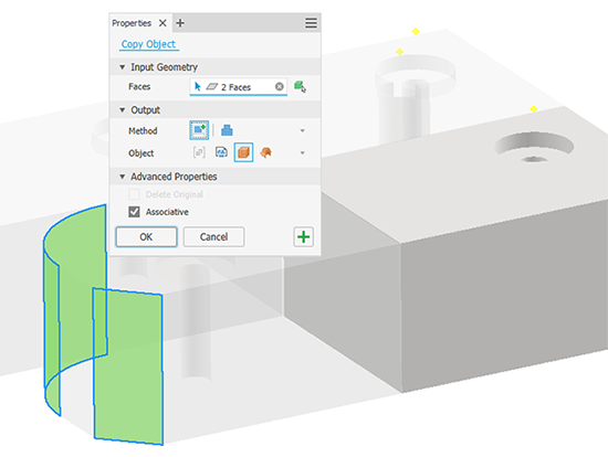

Copy Object
For more about the Copy Object command see: To Copy Objects Between Part, Assembly, and Construction Environments

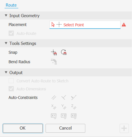

Route
For more information about routes, see To Work with Tube and Pipe Routes.

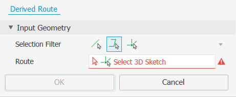

Derived Route
For more information about derived routes, see To Create Derived Routes in Tube and Pipe.

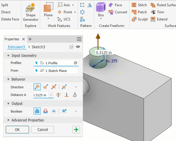

Value Edit controls and HUD - After selecting a feature dimension, the cursor is positioned at the end of the field. Improves support for creating formulas or equations.
