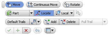

Tweak command is redesigned to use direct manipulation tools arranged in the Tweak Components minitoolbar.
The Tweak Components minitoolbar includes many new commands.
The triad manipulator is modernized and its appearance is similar as in Inventor direct edit commands.
The triad can use the world coordinate system or local coordinate system of the attached component. When local coordinate system is used, you can align the triad to the component geometry.
When you create a tweak, you can dynamically add or remove components included in the selection set.
When you edit an existing tweak, you can redefine the set of components participating in the tweak.
When you create or edit a tweak, an edit box with the distance or angle value is attached to the triad manipulator. When you edit the value, the tweak is updated accordingly.
When you create a tweak, component positions and created trails are dynamically previewed.
When you edit a tweak, components are rolled back so that you can preview the edited tweak.
When you create tweaks, you can go back one step and cancel the previous tweak by the Undo button. The tweak history and the Undo button are available until you click Apply in the Tweak Components minitoolbar.
None cancels creating trails.
All Components creates trails for all selected components.
All Parts creates trails for all selected parts, excludes subassemblies from creating trails.
Single creates a single trail for the entire tweak regardless of the number of moved components. The trail starts from the triad location.
Use the direct editing tools on the Tweak Components mini toolbar to manually add, edit, or delete trails or trail segments.
When the default trails do not match your needs, you can add trails or trail segments manually. On the Tweak Component minitoolbar, click
Add , and select Full Trail or Trail Segments. Then in the graphic window, click a point on the tweaked component to add a trail.
