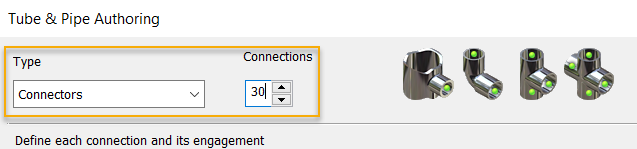

You can now author a part with up to 30 connections. Previously, the maximum was 10.
For more information on authoring Tube and Pipe parts, see To Author Tube and Pipe Parts.

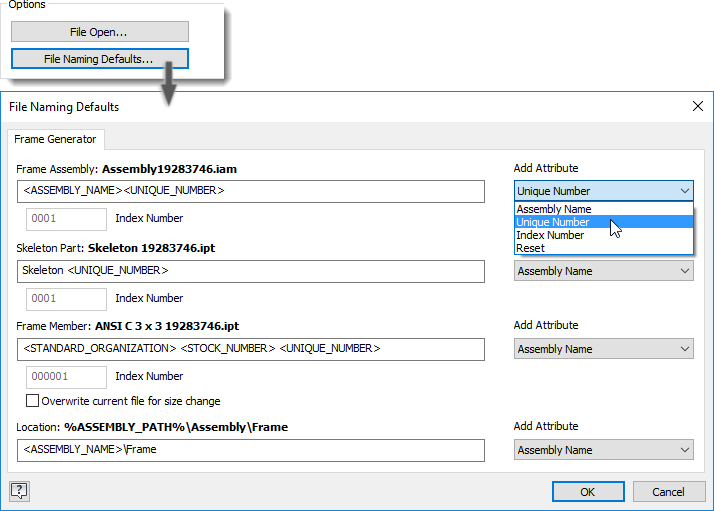

In the File Naming Defaults dialog, click the Add Attribute drop-lists to configure your naming scheme.
For more information, see File tab, Application Options.

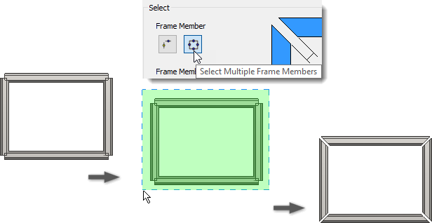

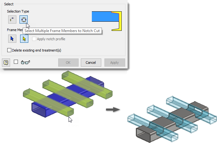

For more information about Miter and Notch, see Modify or apply end treatments to frames.

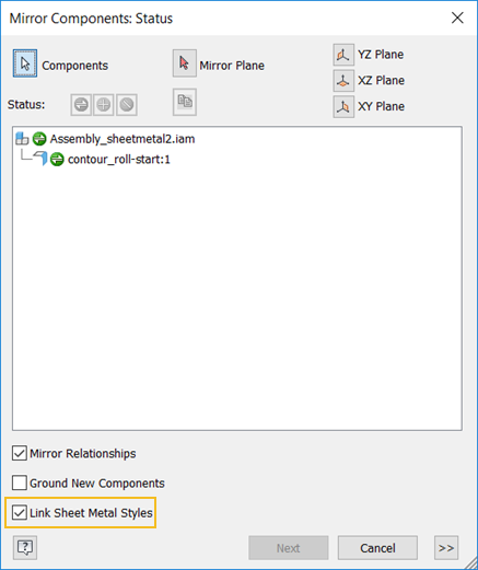

Mirror Components/Sheet Metal Enhancement
The Mirror component command now recognizes a sheet metal part and lets you link the sheet metal style of the source component to the mirrored copy.
For details, see Mirror Components.

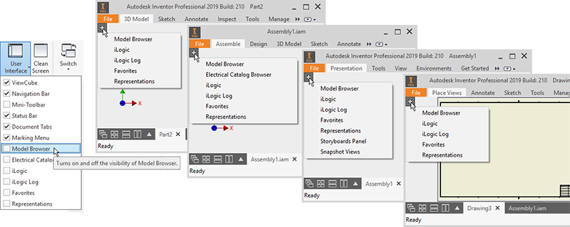

Model Browser Access Enhancement
Access points for the model browser have been added for all document types. When the browser is not displayed, you will see this icon
in the upper left of the graphics display. Click the icon to show the available browser panels for the active document.
For more information, see Inventor Browser.

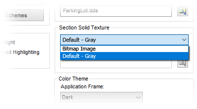

Section Solid Texture
In Application Options
Color tab
Section Solid Texture allows you specify a texture map to use with the capping faces that are used in model Section Views. The default is a Gray color. To use another color, create an image and select the image to use it as a Section Solid Texture.
For more on the application option see: Color Tab Reference (Application Options)

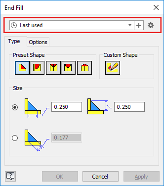

Presets for Existing Commands
You can use Presets to create reusable drawing annotations.
An Inventor® Ideas submission:
For details, see To Work with Presets
For details on 3D annotations, see To Work with General Annotations
For welding details, see To Add or Edit Weld Annotations in a Drawing View
