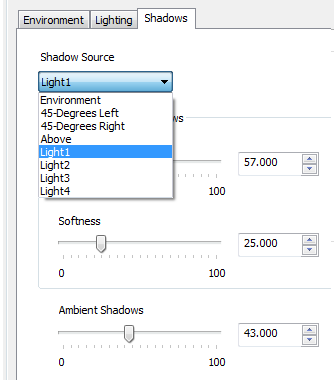

Shadow Settings are managed individually within each Lighting Style. These settings are located on the Shadows tab within the Styles Editor user interface. A new option, Environment, uses the environment image to define Shadow Direction.

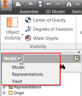

Switch Browser Pane Forward and
Switch Browser Pane Backward toggle commands are available as configurable keyboard shortcut commands through the Tools
Customize command. This enhancement allows you to cycle forward or backward through browser panes that are available in the Inventor model browser; for example:Favorites, Representations, and Vault.

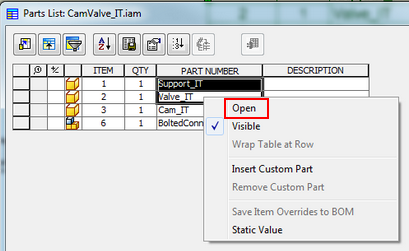

For more information, see About Parts Lists.
