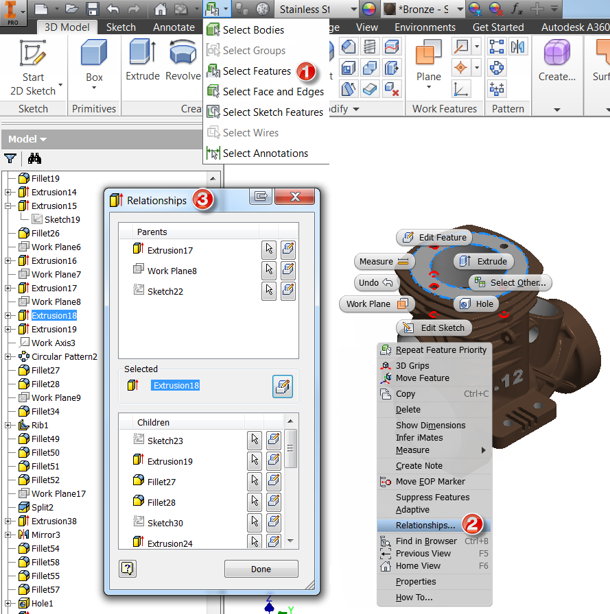

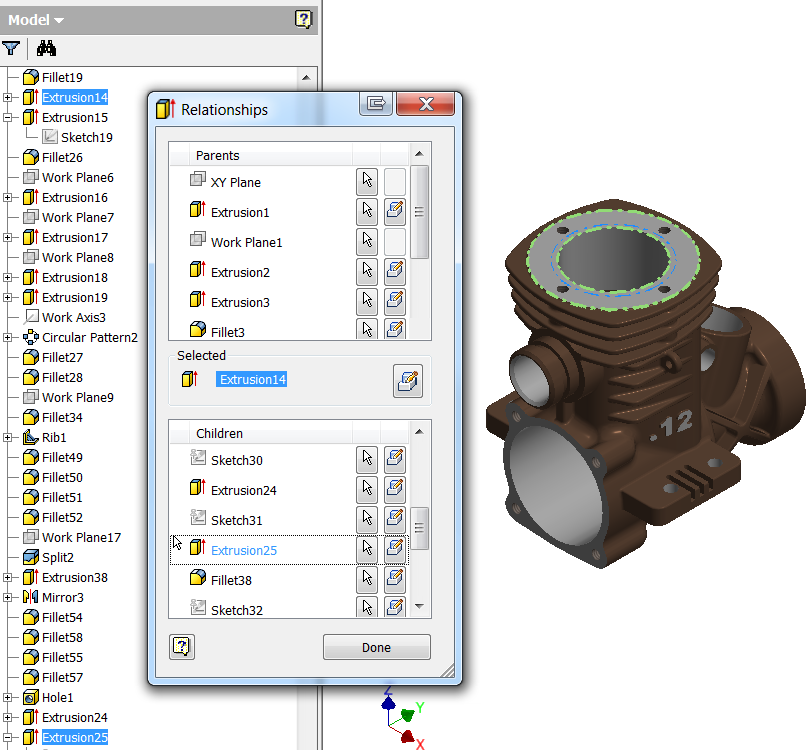

In the Part environment, you can now easily access the parent/child-feature relationships from a part through the model browser or graphics window. This new interactive dialog box allows you to view feature dependencies from directly within your part. In the Relationships dialog box, select the
icon to switch to a Selected view. Select the
icon to access the Edit Feature dialog box.
To access the Relationships dialog box and viewable feature dependencies:
For more information, see To Find Relationships in Part.
