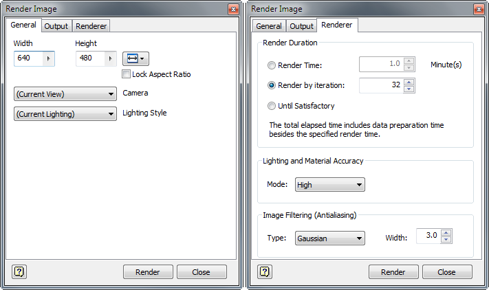

Advanced rendering engine RapidRT provides new configurations for rendering
Obsolete options removed:

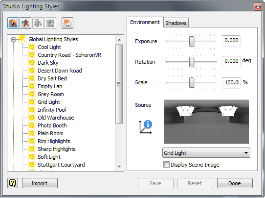

New IBL styles
11 new lighting styles are added to the View tab Appearance Panel Lighting Styles menu. These include Dark Sky, Gray Room, Infinity Pool, Photo Booth, Tranquility Blue, Sharp Highlights, Rim Highlights, Cool Light, Warm Light, Soft Light, and Grid Light.
