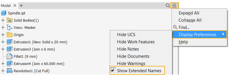

The options, Display extended information after feature node name in browser (available from the Application Options/Parts tab, and Show Extended Name, (available from the Model browser tool's menu) are enhanced to support the following commands:
Work Features
Access: From Application Options/Parts tab
Access from Model browser tool's menu
For more information, see Part Tab Reference (Application Options).

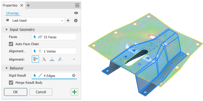

For more information, see To Unwrap Faces.

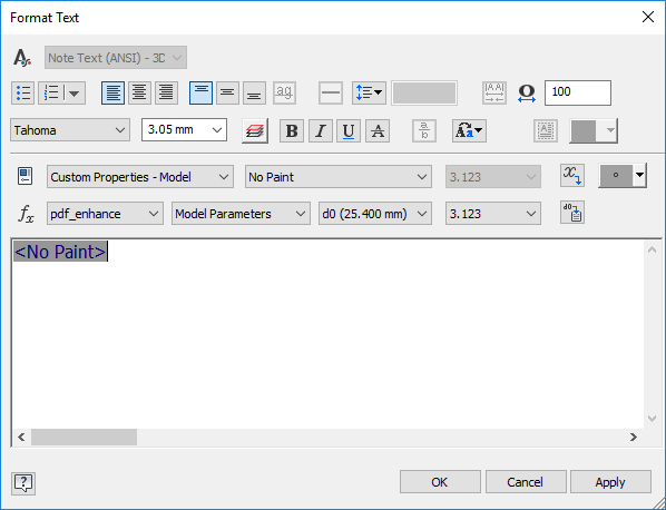

You can now add Custom Properties in the Leader Text, General Note, and General Profile Note commands.
For more information, see To Work with Text and Leaders.
