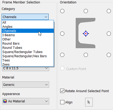

Frame Generator
A new Category section is added to Frame Member Selection in the Insert and Change command to improve searching for a particular Family. When you choose a structural shape Category, the Family list is filtered to show only the available choices.
For more information on constraints, see To Create Basic Structural Frames.

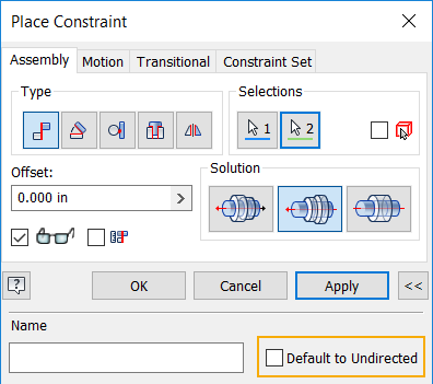

Constraint Enhancement: New Setting to Control Axial Constraints
By default, when creating an axial constraint, Inventor tries to predict the best solution for creating the constraint. The new setting, Default to Undirected, allows you to permanently revert to the legacy behavior which was undirected by default.
For more information on constraints, see Place Constraint Reference - Assembly Tab.

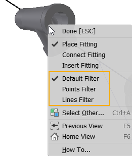

For more information on creating derived routes, see To Create Derived Routes in Tube and Pipe.

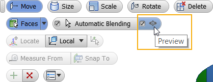

Preview Added to Direct Edit Mini-Toolbar
A preview button is added to the main Direct Edit mini-toolbar for all operations (Move, Size, Scale, Rotate, and Delete).
For more information on Direct Edit, see To Apply Direct Edits to Faces and Solids.

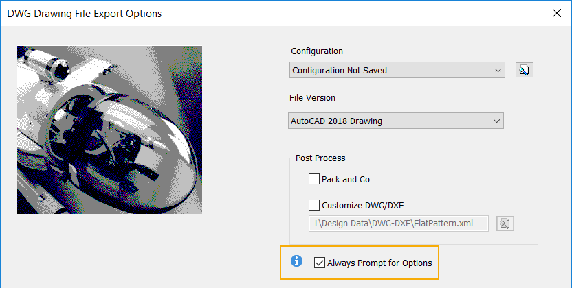

DWG File Export Workflow Enhancements
The workflow for exporting and saving a file as an AutoCAD drawing is streamlined as described below:
 Export
 Export  Export to DWG.
 Export to DWG.
For more information on exporting from a drawing file, see To Export Data to DWG.

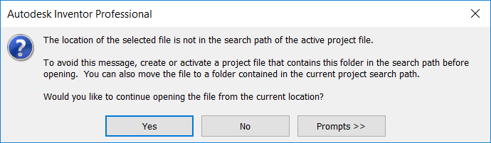

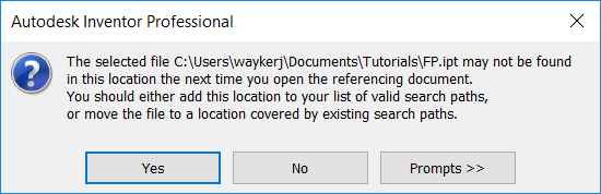

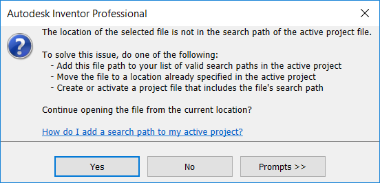

The error handling messages that displays when you try to open a file that is not in the search path of the active project is updated to provide more helpful explanation of how to resolve the issue:
| R2020.2 | Prior to R2020.2 |

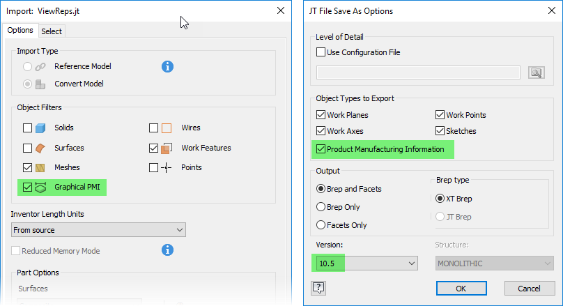

For more information, see Save As Export Options Reference.
