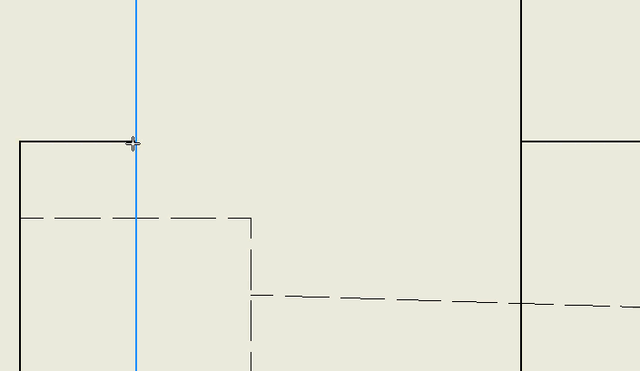

You can now align a dimension to a selected edge. Use the new dimension type, Rotated, to place a dimension and position it perpendicular so that it aligns to the selected edge.

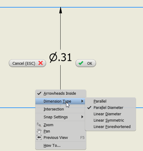

A new dimension type, Parallel Diameter with a Ø symbol, is created when you select the silhouette edge of a cylindrical feature (shaft or hole).
| You can use the context menu option, Dimension Type, to change the dimension type. |
