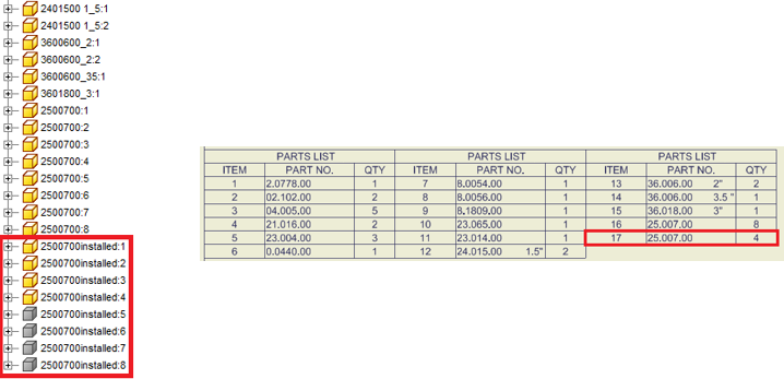

A new Adjust QTY option is added to the Design View Filter for a Parts List in a drawing. The Adjust QTY option is accessible through the Filter Settings dialog box.
When the Adjust QTY checkbox is enabled, the option quantity in a parts list adjusts according to the visibility of the items in the design view. Only these visible parts are taken into account for QTY and ITEM QTY columns in a parts list.
For more information, see Filter Settings Dialog Box.
