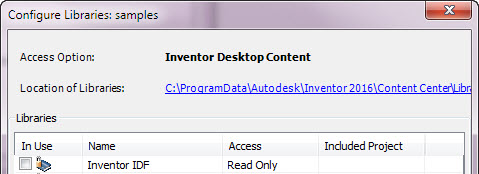

New IDF Component Content Center Library
A new Content Center library for IDF components installs with the 2016 R2.
Author
IDF Component command to the new IDF Component Content Center Library.
