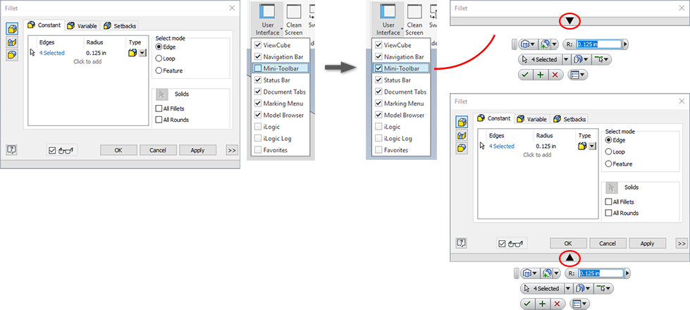

Mini-toolbars No Longer Display by Default
The min-toolbars that display alongside of the 7 Inventor dialog boxes, Extrude, Revolve, Fillet, Shell, Face Draft, Chamfer, and Joint, no longer display by default. You can elect to display or hide the mini-toolbars. To set your preference: On the ribbon, View panel User Interface panel Mini-toolbar.
For more information, see To Hide or Display the Mini-Toolbars.
