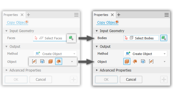

Learn about the enhancements made to Inventor that impact the Part environment.
For more information about using the Split command, see To Combine or Split Bodies and Faces.
For more information about the Copy Object command, see To Copy Objects Between Part, Assembly, and Construction Environments.
