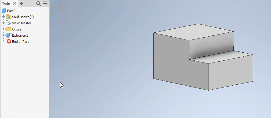

Sketched Features
A sketched feature is a feature that originates from a 2D sketch. Extruding, sweeping, revolving, or lofting a sketched profile creates volume. The volume created by the sketched feature can be joined with, cut from, or defined where it intersects with the volume of an existing feature.
Placed Features
A placed feature consists of a defined mechanical shape that serves a known engineering function in a part or assembly. A placed feature refers to existing extrusion geometry that is used to create new extrusions. Examples are holes, chamfers, fillets, shells, face drafts, and plane cuts.
