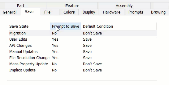

When you close a file with unsaved changes, by default, a prompt asks whether to save changes before closing. Click the entries in the Prompt to Save and Default Condition columns to specify the save behavior for each type of save state. Use the Save files in library folders check box to control the default condition for saving files in Content Center library folders. When deselected, files in library paths will not display in the Save dialog box and will not be saved.
Save state prompts Prompts you to Save when closing a file where:
Migration The active or dependent file was created in an earlier version of Inventor.
Note: After migration, an earlier release of the application cannot read the migrated data files. Migration of a file occurs when you save it. If you do not save the file, the file does not migrate.
User Edits Edits, such as, creating and updating features, were made.
API Changes Changes were made through the API.
Note: Some things you do through Inventor, cause the API to change, such as making to changes that make changes to an add-in. For example, content center workflows, such as placing from Content Center, Changes from Addin such as placing from content center)
Manual Update The Update command was invoked.
File Resolution Change References, when opening a file, were manually resolved (not available in Inventor LT) .
Mass Property Update Physical properties were updated (not available in Inventor LT).
Implicit Update An explicit edit was made that caused a cascading impact in a file. For example, making a change to an assembly, caused a change in he sub-assembly.
