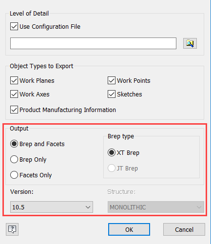

JT File Export Options
Use Configuration File
Check this box to use a pre-defined file that contains the export settings for the Output section. You can use this file to control LOD and other settings if the default export options do not provide the desired results. For example, you can adjust the chordal LOD values to affect larger features and angular LOD values to affect smaller features.
You can find a sample CFG file in [drive]:\Users\Public\Documents\Autodesk\Inventor [version]\Samples\Translation\[language]
The configuration file supports modifying the following areas:
  • Brep and Facets:
    • Brep and Facets: includeBrep = true, includeGeom = true
    • Brep Only: includeBrep = true, includeGeom = false
    • Facets Only: includeBrep = false, includeGeom = true
  • Brep type:
    • XT Brep: autoXtBrep = true
    • JT Brep: autoXtBrep = false. Note: JT Brep type requires version 10.2 or older.
  • Structure: (available for assemblies only)
    • MONOLITHIC: structureOption = "MONOLITHIC" Tip: The assembly is stored in a single JT file.
    • PER PART: structureOption = "PER_PART" Tip: The assembly hierarchy is stored in a single JT file, and each part is stored as a JT file in a subdirectory.
    • FULL SHATTER: structureOption = "FULL_SHATTER" Tip: Each assembly component is stored in a unique JT file.
  • Version: Example, Version 8.0 is written as JtFileFormat = "80", Version 10.5 is written as JtFileFormat = "105"

Output
Select the output options.
Brep type
If you select Version 10.3 and above, JT Brep is not available.
Version
Select the file format version for export.
Structure (not available in Inventor LT)
Available for assemblies only. Specifies a structure type and number of generated files to apply to the exported file. See description of each type in preceding configuration file options.
