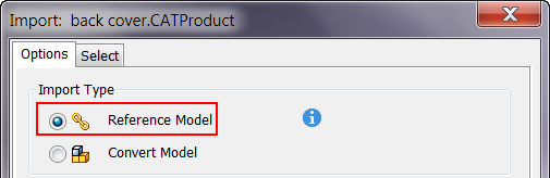

If the design is changing, take control and improve performance by importing the design as a Reference Model. The Reference model option maintains a link to the selected file which enables you to monitor and update Inventor as the model changes. If changes are made to the file in its respective product after import, the Inventor file reflects the changes and downstream references update as well.
Envision an engineering environment in which a standard keyboard design was created as a surface model by an industrial designer using a different CAD program, such as Solidworks. The Solidworks geometry is translated (imported) into Autodesk Inventor as a Reference Model into an assembly file. Importing the file as Reference Model establishes direct associativity between the Solidworks file and the Inventor file. Additional design enhancements are made to the original Inventor geometry using Autodesk Inventor modeling commands: A new part is placed into the assembly and constrained to the imported geometry.
Meanwhile, the industrial designer continues to modify the Solidworks design into a more organic, ergonomic shape. The Update icon
on the Quick Access toolbar indicates that the original imported file was edited since it was initially imported into Inventor. Now the Autodesk Inventor part file is no longer in sync. Clicking the Update icon loads the revised imported file and incorporates the changes.

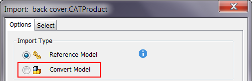

You can import the following files as an AnyCAD convert model: Fusion 360, CATIA, Solidworks, Solid Edge, Pro-E/Creo, NX, JT, Alias, Rhino, IGES, Parasolid, STEP, and SAT.
The Convert Model option creates new Inventor files which are not linked to the original. Use this option if you plan modify the model for a new design.
The Convert Model operation does not maintain associativity with the original file. As a result, changes to the original file after the import operation do not affect the imported part or assembly. Likewise, changes to the imported part or assembly do not affect the original file.
The import process creates base features in Inventor representative of the geometry and topology in the source file. You can use Inventor commands to adjust the base features and add new features to the Inventor feature tree. You cannot modify the original definition of the base features.

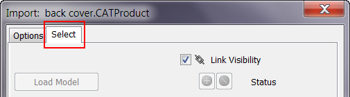

If you do not need to import an entire model, you can specify which bodies (into a part file) or which parts (into an assembly file) to include. Import only the components you need to improve performance.
