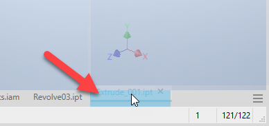

  • Add a document to the window by dragging a document tab into the tab bar until the blue frame edge previews below the tabs, then drop it. The document window remains a single document type.
  • Create a tab group by dragging a document tab into the tab bar next to another document until the blue tab preview displays, then drop it. The documents share the window frame.
    Tip: If you see the blue frame edge highlight just move the cursor up a little, to mid-tab, and the tab preview displays.

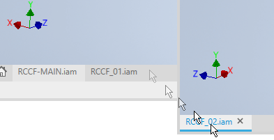

  • Create a new application window by dragging a document tab and dropping it in the graphics display, desktop, or another monitor.
  • Create a new application window set
    by dragging the set tab bar out of the main window to the graphics display, desktop, or another monitor

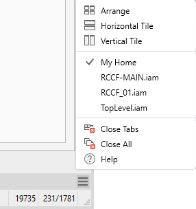

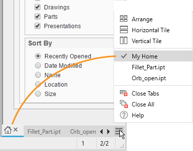

You can create window layouts using the Documents menu at the right end of the window tab bar.
  • Arrange - arranges all documents in the current window in a grid. Tab groups are dispersed into individual documents. All minimized documents are ignored.
  • Horizontal Tile - arranges all documents in the current window horizontally in a grid. Tab groups are dispersed into individual documents.
  • Vertical Tile - arranges all documents in the current window vertically in a grid. Tab groups are dispersed into individual documents.
  • Documents List - displays thumbnails and filenames of the documents open in that Inventor window. Select a document from the list to activate it.
  • Close Tabs - Closing a secondary window, closes all documents in that window. If any document is in a changed state, you are prompted to save or discard the changes. Closing tabs in the primary window dismisses all documents, prompting for unsaved changes, and leaving the Inventor session active.
  • Close All - closes all Inventor documents, leaving the Inventor session active.
