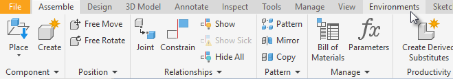

Access Environments within Assembly File (not available in Inventor LT)
  1. In an assembly file, on the ribbon, click the Environments tab.
  2. Click one of the available environments.
Note: Dynamic Simulation and Stress Analysis are available in both the Autodesk Simulation products and in Autodesk Inventor Professional. Cable and Harness, and Tube and Pipe are available only in Autodesk Inventor Professional.

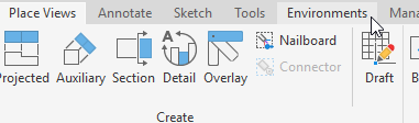

Access Environments within Drawing File
