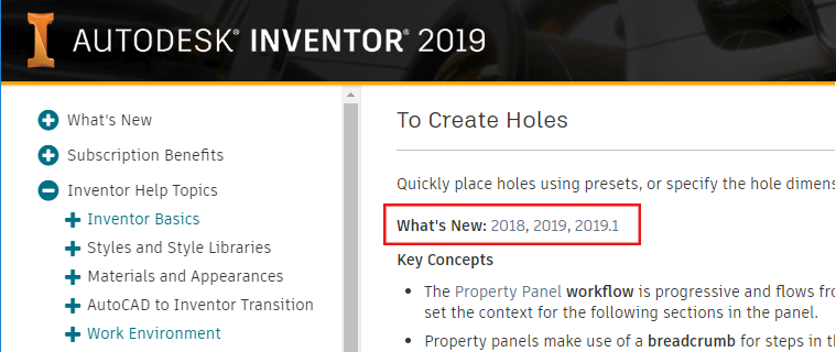

For easy access to the What's New information, links are provided at the top of the Help topic.

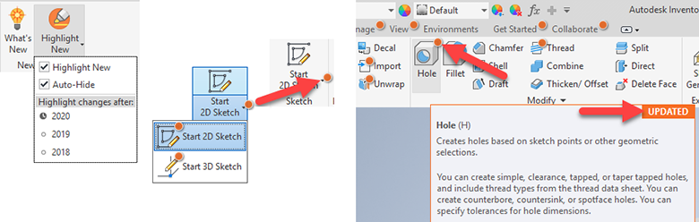

The Highlight New badges are accessed from the Get Started tab New Features panel.
    To Show Badges on New or Updated Commands
  1. On the Get Started tab > New Features panel click Highlight New . The list of Releases and Updates displays. Off is the default setting.
  2. Select a release or update. Badges display on the Ribbon commands that were updated or new after the selected release or update. For example, in the following image commands that were new or updated after 2018.3 will have badges on them.

Corresponding Help Page Change
For commands displaying a New or Updated badge, when you use F1 to get to a Help page, at the top of the page you will see links to the What's New topic that explains the change to the feature or command. The links show the release in which a related change took affect.
