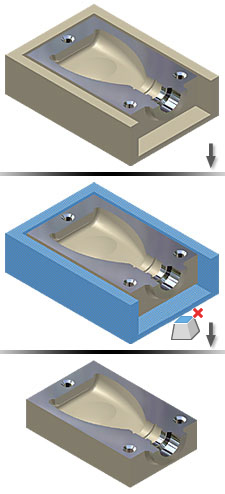

Delete one or more faces, using the Heal option to extend adjacent faces. Gaps between faces, such as when a fillet is deleted, are repaired by extending the adjacent faces until they intersect.

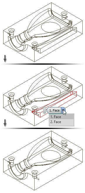

Delete a lump, such as a result of defining a mold base. A lump is a group of faces that may contain some or no void. A part or surface body should have at least one lump. When you model the mold shape and cut the part from the base, a lump remains. Use Delete Face to delete the lump from the cavity.
Delete a void to restore mass to the model. A void is a group of faces that define an internal hollow space. Some modeling operations, such as a shell without removing a face, create a hollow inside a model that you later want to remove. Because the void is hidden inside a model, you cycle through selections using the Select Other method to highlight the void to delete.

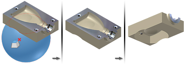

Use Replace Face to select both the face to replace, and the new face. A Replace Face feature is created. You can edit it with sketch and feature commands.
When replacing part faces:
- Solid faces, surfaces, or work planes are selectable as replacement faces.
- The part body must completely intersect the new face. For best results, the new face should be larger than the face being replaced and is trimmed to match the size and shape of the body. The original part face does not expand or contract to match the new face dimensions.
