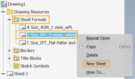

To Create a New Sheet
In a drawing template or drawing file:
- In the browser, expand Drawing Resources
Sheet Formats. Right-click on a sheet format, and select New Sheet.
- In the Select Component for View on Sheet dialog box, select a model file to place views of the model in the sheet and click OK.
- Select the browser node of the new sheet and enter a descriptive name.
- To customize the view settings to adhere to your company standards, right-click the view, and select Edit View from the context menu.

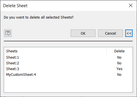

To Delete Drawing Sheets
- In the browser, select one or more sheets to delete.
- Right-click, and select Delete from the menu.
- (Optional) To change which sheets are selected for deletion, in the Delete Sheets dialog, click More
, and then click Delete to specify which sheets to delete.
- Click OK to delete specified sheets.
