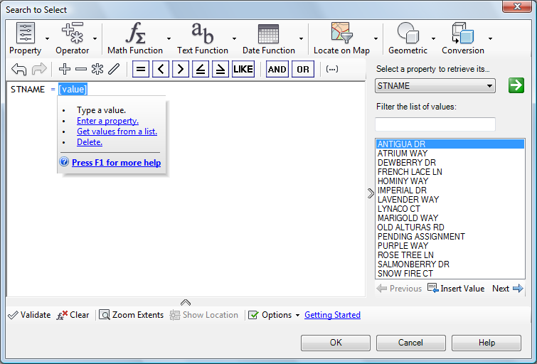

To find the parcel to split
When Auto-Zoom is on, it is a different color than the window background
. When it is off, it is the same color as the window background.
The properties list is populated when you click the green arrow. Your selection replaces the selected value.
Click Next if you do not see Antigua in the list.
In the Data Table, the entries for parcels on Antigua Drive are highlighted. The map is zoomed to that street, and the parcels are selected in the map as well.
