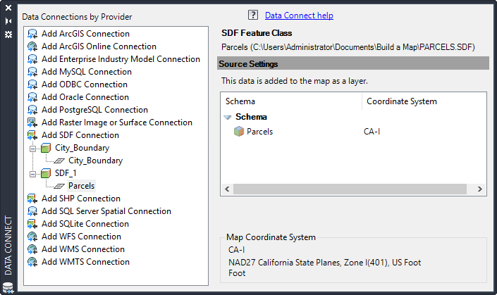

Use Data Connect to connect your map to a file containing parcel data.
Use the Data Connect window to attach any non-DWG data source:
Data Connect displays information about all attached non-DWG data sources, even if you did not use Data Connect to attach them. For example, the SDF file you dragged and dropped into your map is listed in the Data Connect window.

Connect to Data.
Under Add Data To Map, Parcels is selected.
The coordinate system for this feature class is displayed next to its name. If this information was incorrect, you could click Edit Coordinate Systems to change the coordinate system.
In the Data Connect window, connect to a data provider and then select the feature class you want.
When you click Add To Map, a layer called Parcels is displayed in the list in the Display Manager . A layer can be styled, saved, displayed, or hidden, independent of other layers in your map.
