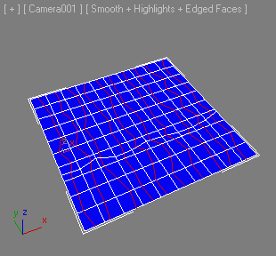

EXAMPLE
Random Connecting Within a 10x10 Grid using autoLoop passed as true:
--Step 1: p = plane lengthsegs:10 widthsegs:10 wirecolor:blue --create a plane convertTo p Editable_Poly --convert the plane to Editable_Poly select p --select the plane to be able to see the results max modify mode --switch Command Panel to Modify mode subObjectLevel =2 --switch to polygonsub-object level polyOp.setEdgeSelection p #{82} --select one edge to define a loop --Step 2: PolyToolsModeling.RandomConnect 0.3 true --create loops and connect randomly
Note that although there was just a single edge selected, the AutoLoop second argument set to true produced an edge ring from the selected edge, then performed the random connect over the new selection. With autoLoop false, no connection edges are created.
--Step 3: PolyToolsModeling.RandomConnect 0.3 true --create loops and connect randomly --Step 4: PolyToolsModeling.RandomConnect 0.3 true --create loops and connect randomly
In the third step, we start once again from a single edge loop which, if used with autoLoop set to false, would not produce any connections. Now we produce a large number of parallel random loops, but they are "blocked" by unselected straight edgeloops which would once again produce no connections if autoLoop would be passed as false in the fourth step.

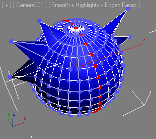

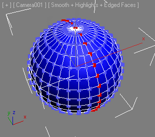

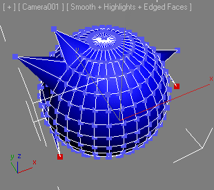

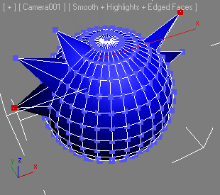

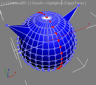

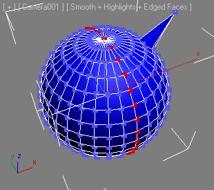

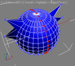

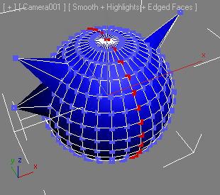

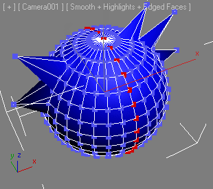

EXAMPLES
Using the Symmetry methods:
--Step 1: s = sphere radius:12 segs:32 wirecolor:blue convertTo s Editable_Poly select s max modify mode subObjectLevel = 1 PolyToolsModeling.SymmetryGather s #x 0.01
--Step 2: PolyOp.moveVert s #{122} [5,0,5] --Step 3: PolyToolsModeling.SymmetryPosToNeg #x
--Step 4: PolyOp.moveVert s # {170} [-5,0,0] --Step 5: PolyToolsModeling.SymmetryNegToPos #x
--Step 6: PolyOp.moveVert s #{58} [3,0,5] --Step 7: PolyToolsModeling.SymmetryFlip #x
--Step 8: PolyOp.setVertSelection s #{122,170} PolyToolsModeling.SymmetryCopy() PolyOp.moveVert s #{122,170} [5,0,-20] --Step 9: PolyToolsModeling.SymmetryPaste()
