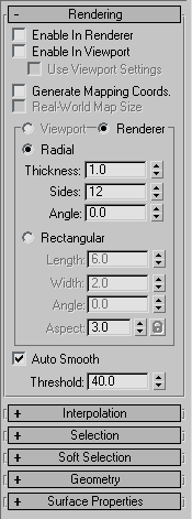

Properties
Rendering Rollout
Properties:
<SplineShape>.render_renderable BooleanClass default: false -- boolean; renderable
Toggles the "Enable in Renderer" checkbox on and off.
Available in 3ds Max 8 and higher.
<SplineShape>.render_displayRenderMesh BooleanClass default: false -- boolean; displayRenderMesh
Toggles the "Enable In Viewport" checkbox on and off. When set to true, the mesh will be displayed in the viewports.
<SplineShape>.render_useViewportSettings BooleanClass default: false -- boolean; useViewportSettings
Toggles the "Use Viewport Settings" checkbox on and off.
When set to true, the mesh displayed in the viewport will use the Viewport settings.
When false, the Renderer settings will be used for the viewport mesh.
<SplineShape>.render_mapcoords BooleanClass default: false -- boolean; mapcoords
Toggles mapping coordinates generation on and off.
The U coordinate wraps once around the thickness of the spline; the V coordinate is mapped once along the length of the spline.
<SplineShape>.realWorldMapSize BooleanClass default: false -- boolean
Toggles the real-world map size option on and off.
<SplineShape>.render_displayRenderSettings BooleanClass default: true -- boolean; displayRenderSettings
Toggles the state of the Viewport/Renderer radio buttons.
When set to true, the Renderer settings will be displayed in the rollout.
When false, the Viewport settings will be shown instead.
<SplineShape>.render_rectangular BooleanClass default: false -- boolean
When set to true, enables the Rectangular cross-section mode to be used in the renderer.
When false (default), enables the Radial cross-section mode.
Corresponds to the Radial/Rectangular radio buttons in the UI in the Renderer mode.
<SplineShape>.render_viewport_rectangular BooleanClass default: false -- boolean
When set to true, enables the Rectangular cross-section mode to be used in the viewports.
Corresponds to the Radial/Rectangular radio buttons in the UI in the Viewport mode.
Renderer - Radial Cross-Section
Properties:
<SplineShape>.render_thickness Float default: 1.0 -- animatable; thickness
Gets/Sets the diameter of the Radial renderable spline mesh.
<SplineShape>.render_sides Integer default: 12 -- animatable; sides
Gets/Sets the number of sides for the spline mesh in the renderer.
For example, a value of four will give you a square cross section.
<SplineShape>.render_angle Float default: 0.0 -- animatable; angle
Gets/Sets the rotational position of the Radial cross-section in the renderer.
Renderer - Rectangular Cross-Section
Properties:
<SplineShape>.render_length Float default: 6.0 -- animatable
Gets/Sets the length of the Rectangular renderable spline mesh.
<SplineShape>.render_width Float default: 2.0 -- animatable
Gets/Sets the width of the Rectangular renderable spline mesh.
<SplineShape>.render_angle2 Float default: 0.0 -- animatable
Gets/Sets rotational position of the Radial cross-section in the renderer.
<SplineShape>.render_aspect_locked BooleanClass default: false -- boolean
Controls the state of the Aspect Lock checkbutton.
When set to true, changing the Width will affect the Height and vice-versa, preserving the aspect at the time the lock was engaged.
Viewport - Radial Cross-Section
Properties:
<SplineShape>.render_viewport_thickness Float default: 1.0 -- float; viewport_thickness
Gets/Sets the diameter of the Radial renderable spline mesh in the viewport.
<SplineShape>.render_viewport_sides Integer default: 12 -- integer; viewport_sides
Gets/Sets the number of sides for the Radial spline mesh in the viewports.
<SplineShape>.render_viewport_angle Float default: 0.0 -- float; viewport_angle
Gets/Sets the rotational position of the cross-section in the viewports.
Viewport - Rectangular Cross-Section
Properties:
<SplineShape>.render_viewport_length Float default: 6.0 -- float
Gets/Sets the length of the Rectangular spline mesh in the viewports.
<SplineShape>.render_viewport_width Float default: 2.0 -- float
Gets/Sets the width of the Rectangular spline mesh in the viewports.
<SplineShape>.render_viewport_angle2 Float default: 0.0 -- float
Gets/Sets the rotational position of the Rectangular cross-section in the viewports.
<SplineShape>.render_viewport_aspect_locked BooleanClass default: false -- boolean
Auto Smooth
Properties:
<SplineShape>.render_auto_smooth BooleanClass default: true -- boolean
Controls the state of the Auto Smooth checkbox.
When set to true, auto smoothing will be enabled.
<SplineShape>.render_threshold Float default: 40.0 -- animatable;
Gets/sets the Auto Smooth Threshold value. Available in 3ds Max 8 and higher.

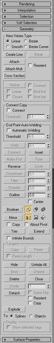

Geometry Rollout
Create, Break, Attach
Methods:
splineOps.startCreateLine <editable_spline_or_line_node_or_modifier>
Enters the "Create Line" command mode. It is valid in all Sub-Object levels and when not in the Sub-Object mode.
See Editable Spline Modify Panel Command Modes and Operations for the full list of UI-related methods.
splineOps.startBreak <editable_spline_or_line_node_or_modifier>
Enters the "Break" command mode. It is valid in Vertex and Segment Sub-Object levels.
splineOps.startAttach <editable_spline_or_line_node_or_modifier>
Enters the "Attach" command mode. It is valid in all Sub-Object levels and when not in the Sub-Object mode.
splineOps.attachMultiple <editable_spline_or_line_node_or_modifier>
Displays the Attach Multiple dialog allowing the user to select multiple shapes to attach. Valid in all Sub-Object levels and when not in the Sub-Object mode.
Refine
Methods:
splineOps.startRefine <editable_spline_or_line_node_or_modifier>
Enters the "Refine" command mode. It is valid in Vertex and Segment Sub-Object levels. This method does not turn off the Connect checkbox, so it is effectively the same as the startRefineConnect() method.
splineOps.startRefineConnect <editable_spline_or_line_node_or_modifier>
Enters the "Refine" command mode. It is valid in Vertex and Segment Sub-Object levels. This method does not turn on the Connect checkbox, so it is effectively the same as the startRefine() method.
Weld, Connect, Insert, Make First, Fuse, Reverse, Cycle
Methods:
splineOps.weld <editable_spline_or_line_node_or_modifier>
Welds the selected vertices. It is valid in the Vertex Sub-Object level.
See also the related methods in ShapeMethods-Weld.
splineOps.startConnect <editable_spline_or_line_node_or_modifier>
Enters the "Connect" command mode. It is valid in the Vertex Sub-Object level.
splineOps.startInsert <editable_spline_or_line_node_or_modifier>
Enters the "Insert" command mode. It is valid in all Sub-Object levels, and when not in the Sub-Object mode.
splineOps.makeFirst <editable_spline_or_line_node_or_modifier>
Makes the selected vertices the first vertex in the spline. It is valid in the Vertex Sub-Object level.

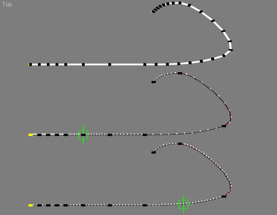

VERTEX AND LENGTH INTERPOLATION METHODS:
There are two methods to interpolate a position along the spline: vertex interpolation and length interpolation.
When using vertex interpolation (path interpolation), the spline is seen as a number of segments where each segment between two vertices is a normalized space from 0.0 to 1.0. The distance between the two vertices of a segment is ignored during the interpolation, which means that if the lengths of the segments are different, interpolating linearly along the spline will result in varying speed.
You can visualize this on a Path Constraint with Constant Velocity unchecked where the object is moving faster between two vertices when the segment between them is longer (see the image below).
When using length interpolation, the whole spline length is normalized, so a parameter of 0.5 will be exactly in the middle of the spline regardless of the segments' lengths. The speed of a point interpolated along the spline using a parameter that changes linearly between 0.0 and 1.0 will remain constant along the whole spline even if the vertex placement is irregular.
This can be demonstrated when checking the Constant Velocity checkbox in the Path Constraint that enables the length interpolation:
In this image, the top object is a SplineShape with varying segment length and ten segments.
The middle object is a copy of the same shape used as a path by a Point Helper. The Constant Velocity checkbox was unchecked in the Path Constraint causing it to use vertex interpolation. For 100 frames, it divided the shape in ten segments and placed ten samples on each segment resulting in varying speed dependent on the length of the segment.
The bottom object is a copy of the same shape used as a path by another Point Helper, but this time Constant Velocity is turned on causing it to use length interpolation. You can see clearly that the samples are evenly spaces along the full length of the shape disregarding the distances between the vertices defining the segments.
The time slider was set of frame 50. The length interpolation at the bottom places the point helper exactly at the middle of the path shape, while the vertex interpolation places it exactly on the vertex between the 5 th and the 6 th segment.

The vertex interpolation at the right side hits more or less precisely the start or end vertex and the center of each of the 10 segments because we are stepping with 1/20 th per iteration, while the length interpolation takes into account the actual length of all segments and moves smoothly along the spline.

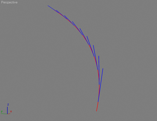

EXAMPLE:
   local sp = splineShape()
   addnewSpline sp
   for i = 1 to 100 by 10 do
   addknot sp 1 #smooth #curve [i, (i*i / 100.0), i]
   updateShape sp
   sp.wirecolor = color 255 0 0
   local count = numknots sp - 1
   for i = 1 to count do
   local pathp = true
   local pt = interpBezier3D sp 1 i 0.50 pathParam:pathp
   local tn = tangentBezier3D sp 1 i 0.50 pathParam:pathp
   local sr = splineShape()
   addnewSpline sr
   addknot sr 1 #corner #line pt
   addknot sr 1 #corner #line (pt + (tn * 30))
   updateShape sr
   sr.wirecolor =blue
RESULT:

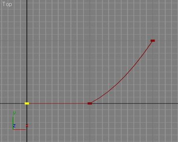

EXAMPLE:

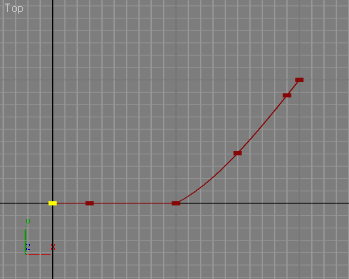

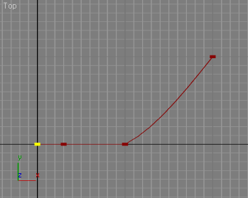

   s = splineShape() --create a spline shape
   addNewSpline s --add a spline to it
   addKnot s 1 #corner #line [0,0,0] --add a knot at origin
   addKnot s 1 #smooth #curve [100,0,0] --add a knot @100 units along X
   addKnot s 1 #corner #line [200,100,0] --add a third knot
   updateShape s --update the shape
   s.vertexTicks = true --enable vertex ticks
   --We have two segments and three knots now.
   refineSegment s 1 1 0.3 --divide the first segment at 30/70% ratio
   updateShape s --update the shape to see the result
   --Since our first segment was 100 units long, the vertex is exactly
   --at 30 units from the origin, just as expected:

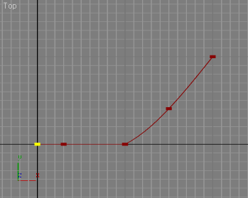

   --now we have 3 segments - the original second segment is not third
   refineSegment s 1 3 0.5 -- let's divide it in two equal parts
   --Because the segment is curved, the knot is not at equal distances
   --to the two other knots along a straight line, but the
   --distances ALONG THE CURVED SEGMENT are equal:
   refineSegment s 1 4 0.8 --divide the new last segment at 80/20% ratio
   updateShape s --and update the shape to see the result:
