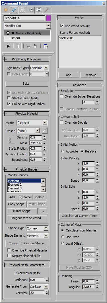

Most of the following Properties are exposed by the MassFX_RBody modifier itself, while the Methods are exposed by the PhysXModRBInterface MixIn Interface.
"Rigid Body Properties" rollout
Properties:
<MassFX_RBody>.type     Integer    default: 1   --  integer; None
Gets/sets the state of the "Rigid Body Type" drop-down list.
Possible values are:
1 - Dynamic (default) - the Rigid Body is driven by the simulation. It is applied gravitational forces, participates in and reacts to collisions with other Rigid Bodies, and so on. Its Rigid Body Mesh cannot be concave.
2 - Kinematic - the Rigid Body is driven by pre-defined (usually keyframed) animation and can drive Dynamic Rigid Bodies, but is otherwise unaffected by the physics simulation. Its Rigid Body Mesh cannot be concave.
3 - Static - the Rigid Body is unyielding and can interact with Dynamic Rigid Bodies, but cannot be animated. Its Rigid Body Mesh can be concave.
<MassFX_RBody>.switchType     BooleanClass    default: false   --  boolean; None

"Physical Material" rollout
Properties:
<MassFX_RBody>.density     Float    default: 0.5   --  float; None
Gets/sets the Density value of the Rigid Body. The Density is measured in grams per cubic centimeter. Changing this value automatically calculates the correct mass for the object based on its volume.
<MassFX_RBody>.mass     Float    default: 1.0   --  float; None
Gets/sets the Mass of the Rigid Body measured in kilograms.
<MassFX_RBody>.staticFriction     Float    default: 0.3   --  float; None
Gets/sets the Static Friction value of the Rigid Body's Physical Material.
Static Friction is the degree of difficulty for two Rigid Bodies to start sliding against one another. A value of 0.0 indicates no friction, a value of 1.0 indicates full friction. The effective static friction between two rigid bodies is the product of their static friction values. If one rigid body has a static friction of 0.0, the value of the other rigid body does not matter (everything slides on wet ice; even sandpaper). Once the two objects start sliding, the Dynamic Friction (see below) applies.
<MassFX_RBody>.dynamicFriction     Float    default: 0.3   --  float; None
Gets/sets the Dynamic Friction value of the Physical Material.
Dynamic Friction is the degree of difficulty for two rigid bodies to keep sliding against one another. Technically, this parameter is called the "coefficient of kinematic friction." A value of 0.0 indicates no friction, a value of 1.0 indicates full friction. In the real world, this value must be less than the coefficient of static friction - it is harder to start pushing an object than to keep it moving. As with static friction, the effective value between two rigid bodies is the product of their respective values.
<MassFX_RBody>.bounciness     Float    default: 0.5   --  float; None
Gets/sets the Bounciness value of the Rigid Body's Physical Material.
This value controls how an object bounces when it hits another rigid body. Technically, this parameter is called the "coefficient of restitution." A value of 0.0 indicates no bounce, a value of 1.0 indicates that the object will bounce off just about as hard as it hit. The effective bounciness between two rigid bodies is the product of their bounciness values.

"Physical Shapes" rollout
Properties:
<MassFX_RBody>.meshType     Integer    default: 4   --  integer; None
1 - Sphere
2 - Box
3 - Capsule
4 - Convex (default)
5 - Convex
6 - Custom
7 - Concave
<MassFX_RBody>.meshOverrideMaterial     BooleanClass    default: true   --  boolean; None;
This property is exposed by the "Override Physical Mesh" checkbox's parameter, but must not be used.

"Forces" rollout
Properties:
<MassFX_RBody>.EnableGravity     BooleanClass    default: true   --  boolean; None
Gets/sets the state of the "Use Gravity" option.
If set to true and if the global Gravity switch in the MassFX World panel is enabled, the Dynamic Rigid Body will be affected by Gravity.
<MassFX_RBody>.forcesList : node array
Gets/sets the array of Force SpaceWarp objects associated with the MassFX Rigid Body simulation.
Array operations like append() and deleteItem() are supported.
Available in 3ds Max 2013 and higher.
"Advanced" rollout
Properties:
<MassFX_RBody>.EnableAdvancedSettings     Integer    default: 1   --  integer
"Simulation" group of controls
Properties:
<MassFX_RBody>.SolverIter     BooleanClass    default: false   --  boolean; None
Gets/sets the state of the "Override Solver Iterations" checkbox.
When set to False (default), the global Iterations count will be used.
When set to True, the MassFX Rigid Body modifier will use the custom number of iterations specified by the .SolverIterValue property (see below).
<MassFX_RBody>.SolverIterValue     Integer    default: 4   --  integer; None
Gets/sets the "Override Solver Iterations" value that is used when the MassFX Rigid Body Modifier's .SolverIter property (see above) is set to True.
<MassFX_RBody>.EnableBackfaceCollision : boolean
Gets/sets whether to use Backface Collision or not.
Default is false.
Methods:
"Contact Shell" group of controls
Properties:
Methods:
"Initial Motion" group of controls
Properties:
<MassFX_RBody>.InitialMotionStyle     Integer    default: 1   --  integer
Gets/sets the state of the Initial Motion Style radio buttons.
0 - Absolute
1 - Relative
<MassFX_RBody>.InitialVelocityX     Float    default: 1.0   --  float; None
<MassFX_RBody>.InitialVelocityY     Float    default: 0.0   --  float; None
<MassFX_RBody>.InitialVelocityZ     Float    default: 0.0   --  float; None
Gets/sets the Initial Velocity X, Y, and Z values of the Rigid Body. These define the direction of the initial velocity.
<MassFX_RBody>.velocitySpeed     Float    default: 0.0   --  float; None
Gets/sets the Initial Velocity's Speed value of the Rigid Body. This defines the magnitude of the Initial Velocity.
<MassFX_RBody>.InitialSpinX     Float    default: 0.0   --  float; None
<MassFX_RBody>.InitialSpinY     Float    default: 1.0   --  float; None
<MassFX_RBody>.InitialSpinZ     Float    default: 0.0   --  float; None
Gets/sets the Initial Spin X, Y, and Z values of the Rigid Body. These define the axis of the initial spin.
<MassFX_RBody>.spinSpeed     Float    default: 0.0   --  float; None
Gets/sets the Initial Spin's Speed value of the Rigid Body.
"Center Of Mass" group of controls
Properties:
<MassFX_RBody>.MassCenterMode : integer
Gets/sets the state of the Center Of Mass radio buttons.
Valid values are:
0 - Calculate from Meshes
1 - Use Pivot
2 - Local Offset
<MassFX_RBody>.MassCenterX     Float    default: 0.0   --  float; None
<MassFX_RBody>.MassCenterY     Float    default: 0.0   --  float; None
<MassFX_RBody>.MassCenterZ     Float    default: 0.0   --  float; None
Gets/sets the X, Y, and Z coordinates of the Rigid Body's Center Of Mass in object space.
See the method .CalculateMassCenter() below for setting these values automatically based on the Rigid Body's meshes.
Methods:
<Point3><MassFX_RBody>.CalculateMassCenter()
Calculates the Center Of Mass and sets the properties .MassCenterX , .MassCenterY , and .MassCenterZ . Returns the result as a Point3 value.
"Damping" group of controls
Properties:
<MassFX_RBody>.LinearDamping     Float    default: 0.0   --  float; None
Gets/sets the Linear Damping value.
<MassFX_RBody>.AngularDamping     Float    default: 2.86479   --  float; None
Gets/sets the Angular Damping value.
