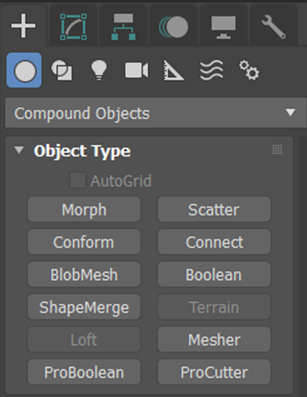

The Boolean3 / BooleanObject2 Compound Object Classes let you create compound Boolean objects. Available in 3ds Max 2017 and higher.
Aliases:
Boolean3
BooleanObject2
Constructor:
No constructor, use:
startObjectCreation BooleanObject2
